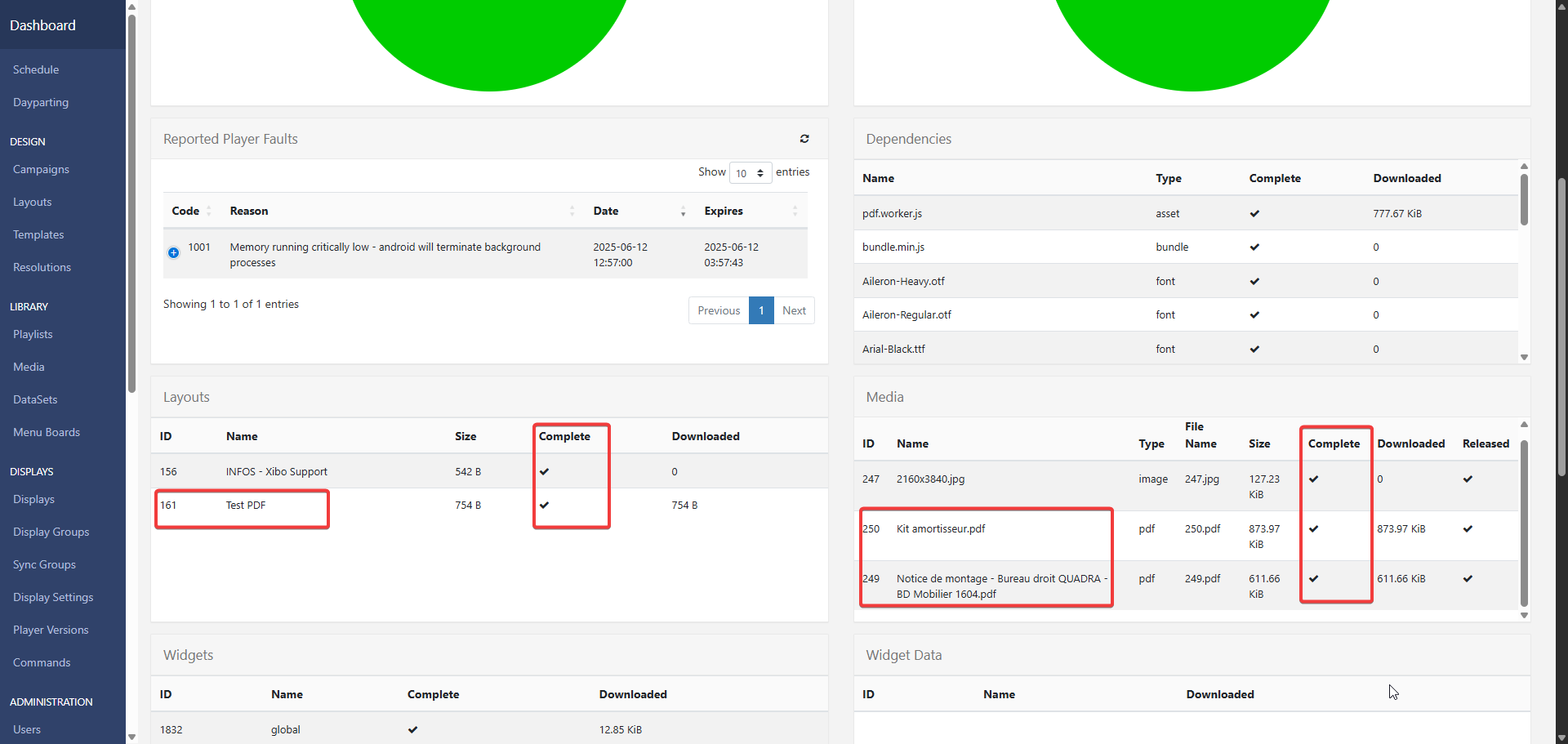

I’ve tested your PDF on CMS V 4.1.2 with an XfA V4 R406 player, and both your PDF files are showing in my display without any errors. If you go to the manage page of the display where you scheduled your layout with the playlist containing the 2 PDF files, do you see if the layout and all the files are completely downloaded? To go to the manage page, go to CMS > Displays > click the row menu > Manage. You should see that under the ‘Complete’ column, there should be a check, and you should not see a downloading symbol.
Here is what it looks like in my ‘Manage’ page for the display where I scheduled the layout with a playlist that has 2 PDF files.
If it shows a downloading symbol on any of the files (the display entry in CMS is in red, which means some files are currently being downloaded or stuck downloading), that would make the layout invalid, and the player will not be able to show it. If so, you need to check if there are any network filtering system that blocks your player from communicating with your CMS. To test, if you have a mobile hotspot, connect your DSCS9X to that network and see if it is able to download all the files and finally show your scheduled PDF layout in your display. If it does work when you are connected to your personal hotspot, that would mean that there could be a network filtering system on the original network where your player is connected that might be blocking the players from downloading the content properly. You need to make sure that the TCP ports below are whitelisted from any network filtering system where your players are connected.

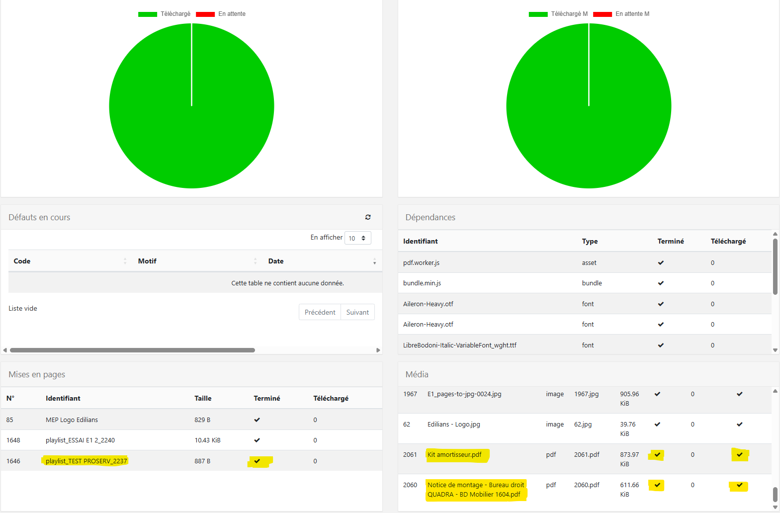

Everything looks good on file downloads:
In fact, it’s the rendering engine on Android that’s not working, because the PDF document viewing time is respected, but in black screen mode.

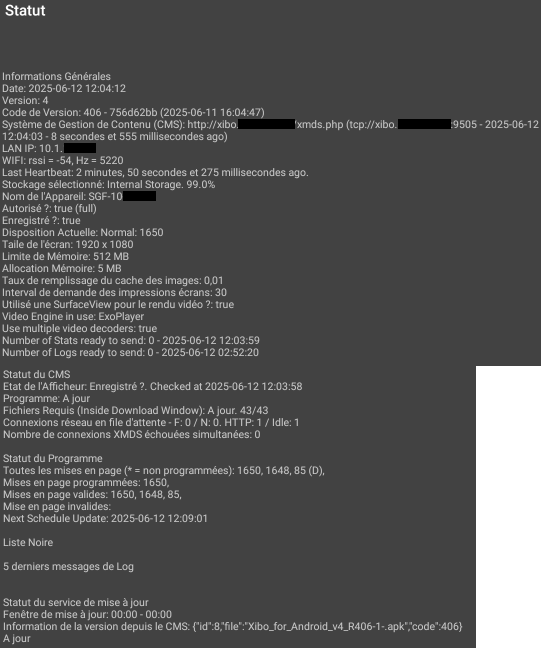

May I please have a screenshot of the ‘Status’ section in your Xibo for Android app where you scheduled your layout? To do so, tap or click on the ‘Status’ option at the top right of your Xibo for Android (XfA) player and try to get the screenshot of the entire log section. Also, may I please have a copy of your test layout, and I’ll test it on my end? You can upload it here and provide me the download link.

Sorry is in French
Here is the layout used for testing: PsiTransfer
No logs last two hours on this player.

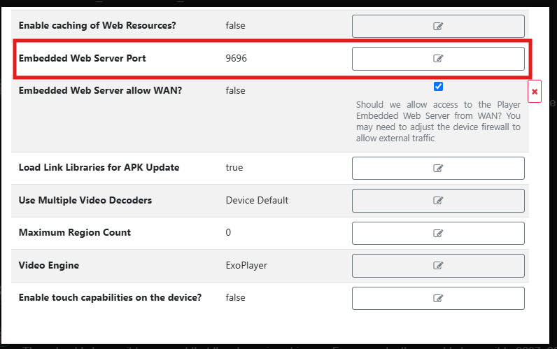

Could you please try to change the port for your webserver to anything that you are sure is free and available to use. Based on the error, it seems that the webserver TCP port 9696 is being used for something else. You could change it to 9697, 9698, 9699, etc as long as the port is free for use.
To change the webserver port in your CMS, go to the Displays > row menu > Edit > Settings and find the embedded webserver port option and change the port from 9696 to any port that’s free to use.
