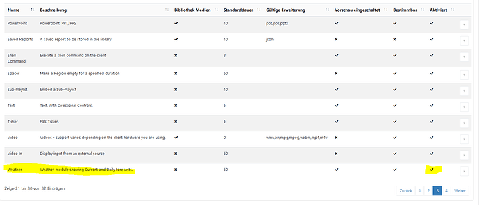

Since upgrade to 3.1.0, the layout designer complains, that the weather module is NOT enabled:
grafik
grafik
But it clearly is?

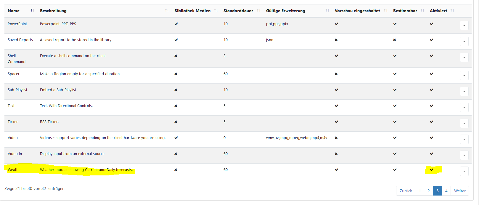

The “Check All” button for modules ran successfully.

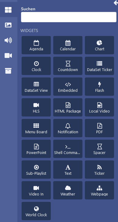

The widget is available in the list:

If you delete the existing Widget from the Layout and then add it again, does it work?
Hmm - I first need to save the current settings from that module, because I made some Css changes. I already thought, that I have to delete and re-add it… I grab the settings and test it. I’ll write back.
I deleted the widget inside the layout and added it back - working again.
