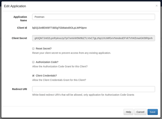

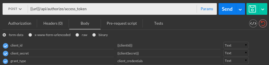

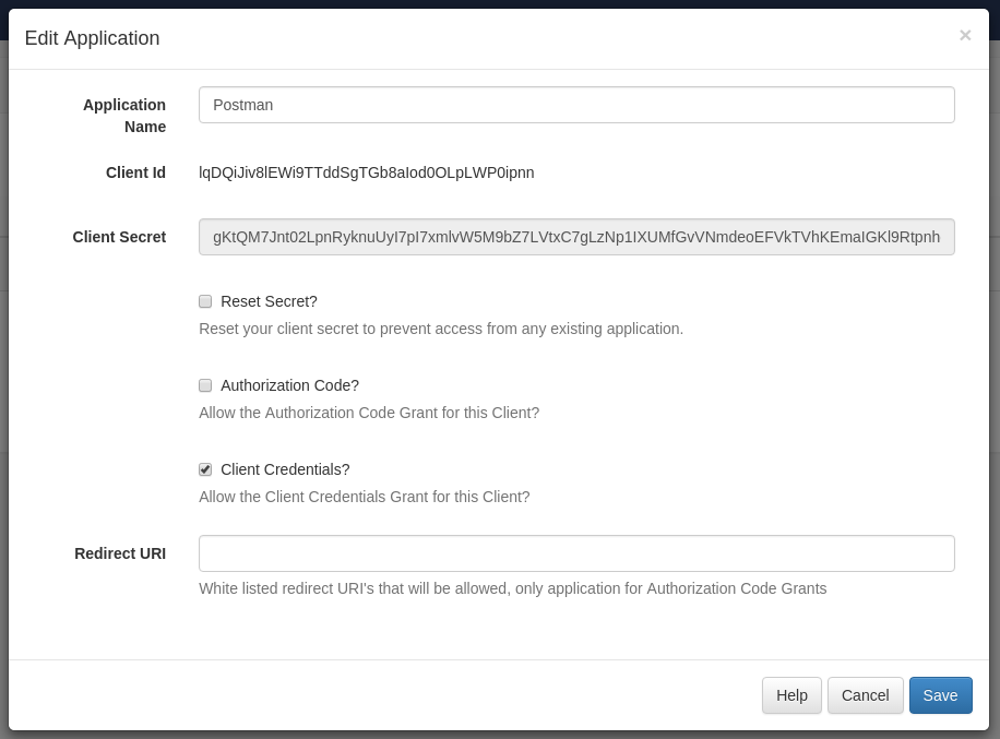

With client_credentials grants you do not need to use the first part of the flow, as your client ID/secret are enough to log you in.
See my postman config for testing this:
You’ll get back an access_token from that directly.
Thank you Dan for the screenshot of the config.
That verifies what we got from the links above, which is helpful to us. We just can’t seem to get the same result with our code. :neutral_face: So we are looking into it.
