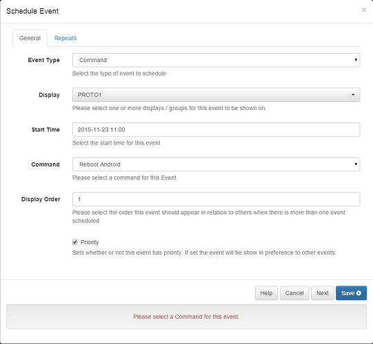

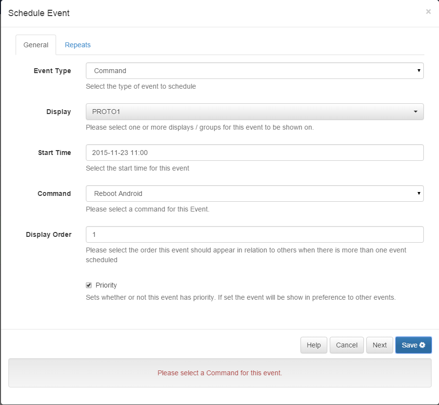

While trying to schedule an event, we get an error.
We have “Even Type” set to “Command” and “Command” is set to a command from the drop down list.
Upon trying to save, you get “Please select a command for this Event.”

Dan, sorry about not being more clear. The problem is within the CMS.
Log:
22746	f2a3029	2015-11-23 10:53	WEB	POST	DEBUG		/schedule	Storage rollback.
22745	f2a3029	2015-11-23 10:53	WEB	POST	DEBUG		/schedule	Please select a Command for this event.
22744	f2a3029	2015-11-23 10:53	WEB	POST	DEBUG		/schedule	Times received are: FromDt=2015-11-23 11:00:43. ToDt=2015-11-23 11:01:00. recurrenceRange=2015-11-23 10:53:25
22743	f2a3029	2015-11-23 10:53	WEB	POST	DEBUG		/schedule	Add Schedule
22742	f2a3029	2015-11-23 10:53	WEB	POST	DEBUG		/schedule	Loading 1. All Objects = 0

The error on the form doesn’t make much sense to me as the validation library is validating that command like so:
It appears that changing that line to:
if (!v::int()->notEmpty()->validate($this->commandId)) {
Will solve the issue.
