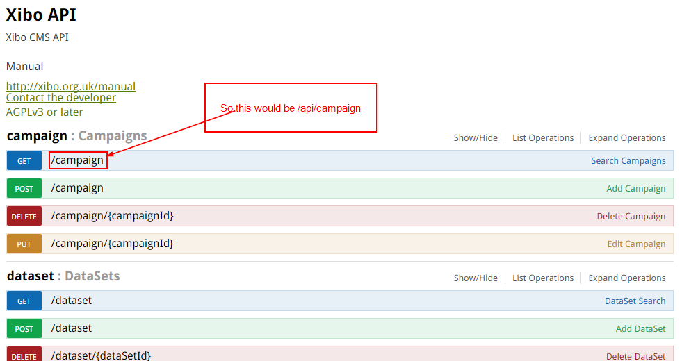

The base URL for the API is /api - if you look at the swagger-ui document you will see all the end points with their various URLs:
The completed API is RESTFul, meaning GET, POST, PUT and DELETE to /api/campaign are all valid and do diffeent things.
