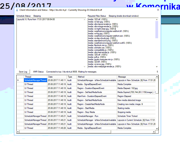

In CMS state i registered. On client connected to: … Waiteng for messeges.

Can we perhaps see a screenshot of status window on your device please?
The player hav connection with CMS but no commends are sending to player. It`s possible that is a communication error betwwen cms container and XMR ?
I see it’s in audit mode now, if you’d, for example, request a screenshot from this player, is there any relevant messaged logged for it on the status window / CMS log page?

When i request command nothing happend on player and there is now messege in status windows.

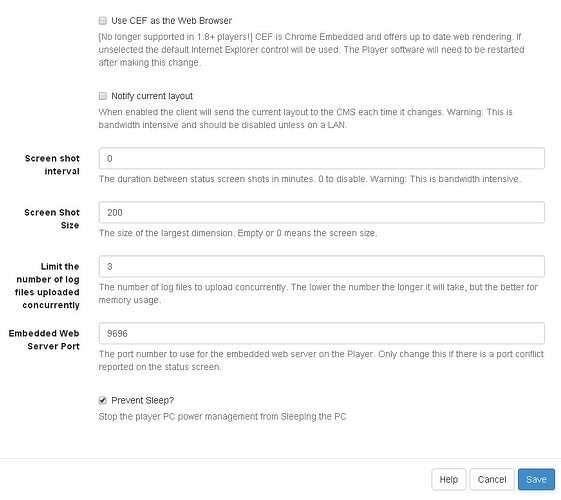

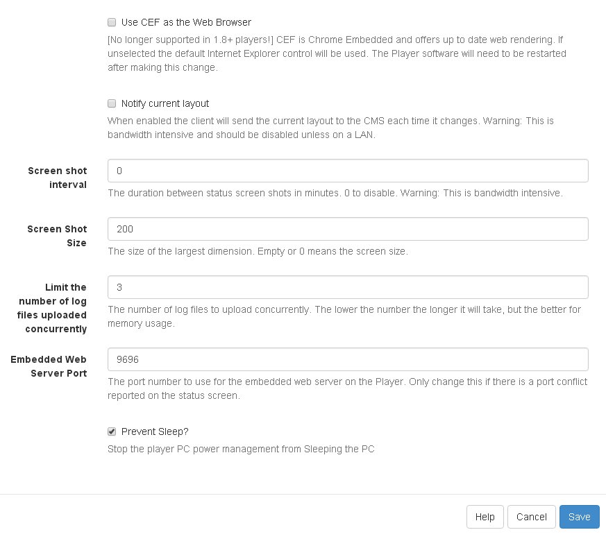

Only screenshots are very small but i dont know why :slight_smile:

Display Setting Profiles → Screen Shot Size

Regarding screenshots size, what hhan said.
