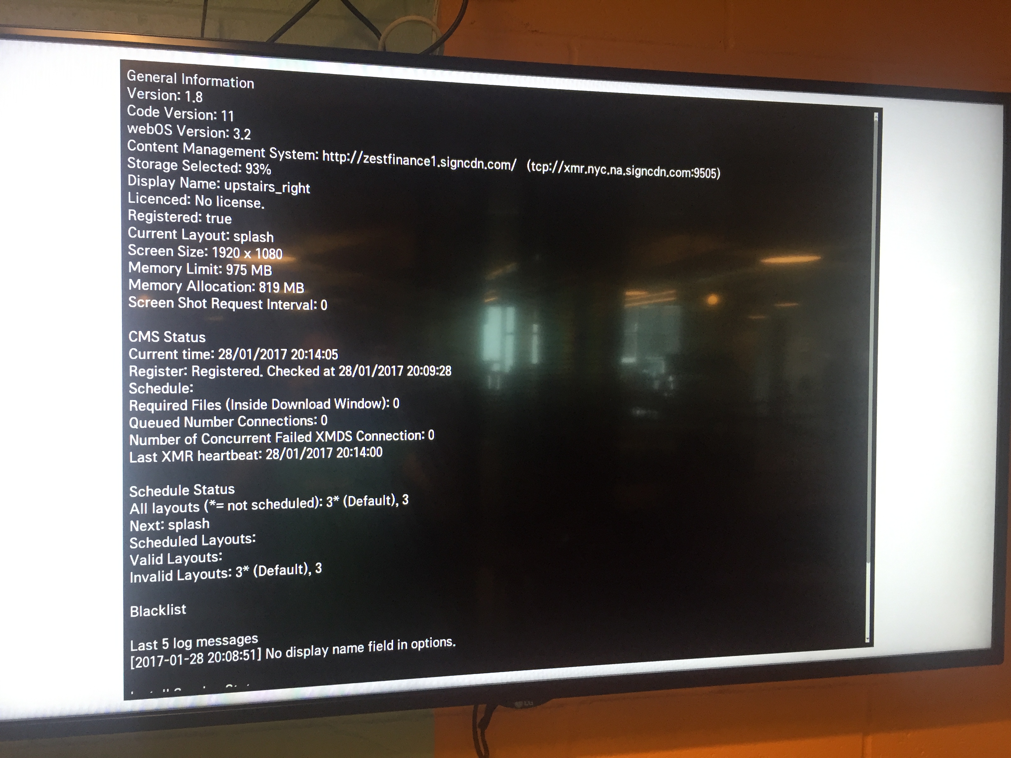

We’ve installed xibo on webos (3.2) about a month ago, both displays are licensed and worked just fine then.
Now, after a month we’ve resumed our work and tried to design the layout properly for long-term, and what’s happening is that the webos player does NOT seem to be refreshing anything from the CMS. It keeps on insisting there are 3 layouts (although there’s only default and 1 additional). As if it wasn’t connecting to the CMS at all.
I’ve tried the following already:
*) deleting the layouts and redesigning
*) removing the CMS instance and creating a new one, the displays DO log-in into the new instance and get authorized but nothing happens further.

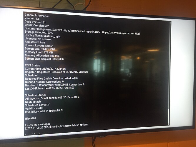

If you look at the screenshot, the displays show as not licensed - even though I’ve purchased the licenses and the email has been provided in the configuration.
I’ve also reset the TV to defaults, and now it shows 6 layouts, but then it also shows that it’s under 15 day trial license while I bought two webOS licenses…
I believe I have replied to your message in our Support desk.
It is most likely due to incorrect date&time settings on the monitor itself as I mentioned in your ticket.
If you look at the Current Time and Checked at that does not seem correct.
