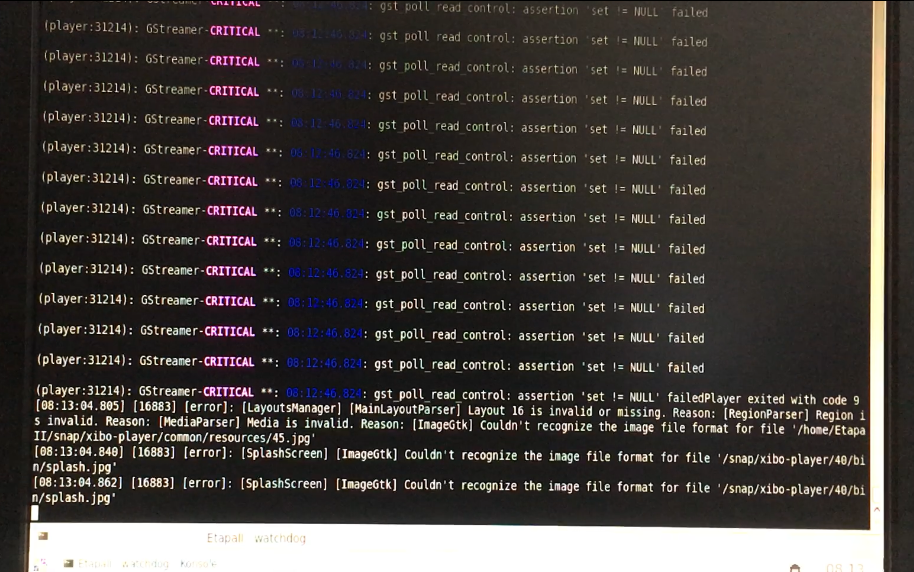

I was the one who reported the error β€œ153: GStreamer gst_poll_read_control assert error after long playback - CentOS 7”.
weeks ago I am testing revision 39 and 40.
update to the candidate version and the result was the same, I have an unstable revision.
I am using the same installation of centos 7, I don’t change anything, just the revision.
written with google translator.

Good morning Dan.
when you let me know that there was a new revision, I updated it.
I attached two images.
-the first one is yesterday
-the second is from today.
with revision 41 the result is the same.
the installations that I have with 1.8 R3 do not present this problem, they all respond to the same xibo server
many thanks
