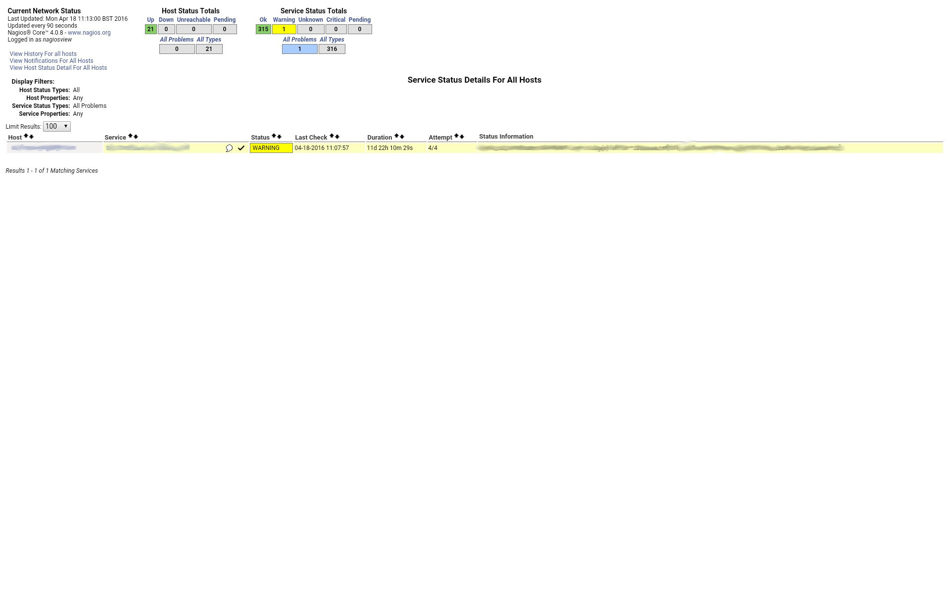

OK I’ve entered it like that here and I don’t see any broken images. See the screenshot below.
I wonder if that’s a bug in the specific version of the firmware on that device? Are you able to upgrade it to latest?
