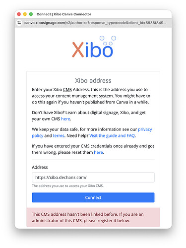

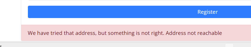

Hi team,
I am hitting the same issue as Canva not linking to Xibo - #2 by natasha
My Xibo is running on HTTPS (letsencrypt) and is publicbly avail.
Xibo logs does not log the attempt to login from canva/canva.xibosignage.com
url:
https:// xibo (dot) dechanz (dot) com
Error:
We have tried that address, but something is not right. Address not reachable

its the same issue, I just tried:
@Nadz yep still the same still

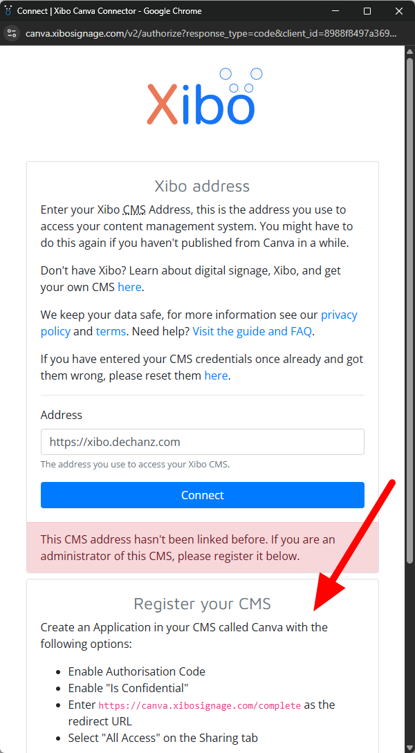

I just tried again, and I tried in between
now it doesn’t even show the error this is the enitre screen:
there isn’t anything below now

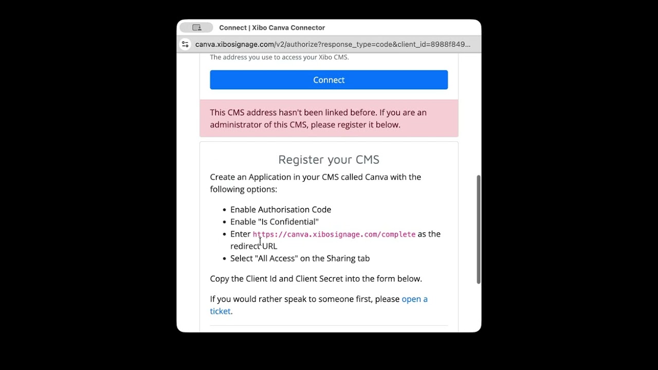

Thanks for the update earlier. I wanted to follow up on the issue you mentioned. I tried connecting to your CMS on my side as well, just to check whether the Registration form appears. In my case, the Registration form shows up just below the Address field, as shown in the screenshot:
When you saw that screen earlier, do you remember if you were able to scroll down the page? It’s possible the Registration form was displayed further down, so I just want to confirm what you saw on your end.
I was, the register your cms section disappears after entering the credentials and no further errors are shown
@nadz I think this new behaviour matched up with after you guys enabled the extra logging, does seem a little strange

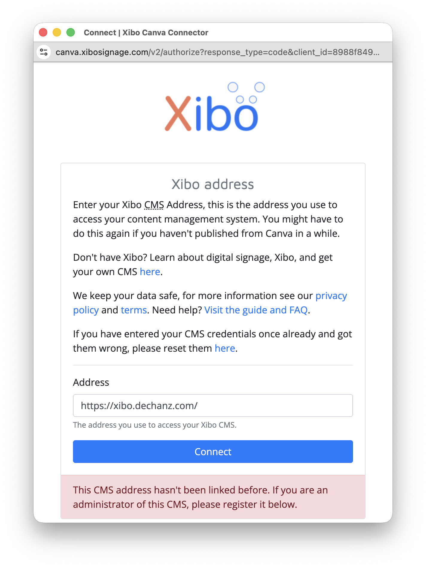

Here is what I experience right now:
I’ve cleared cache and deleted cookies, even using a different browser (firefox vs chrome) it looks the same

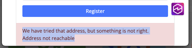

I pressed the connect button at 4.07pm Singapore time, 20 Feb 2026
the error is now “We have tried that address, but something is not right. Address not reachable”

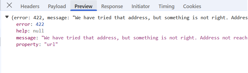

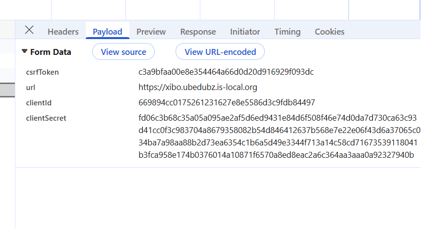

Hi @Nadz , thanks for replying. Here is all the relevant information you requested, along with the HTTP headers:
TIMESTAMP: Sat, 21 Feb 2026 00:21:37 GMT
HTTP Headers:
## GENERAL
Request URL
https://canva.xibosignage.com/register
Request Method
POST
Status Code
422 Unprocessable Content
Remote Address
[2001:41d0:800:a0::]:443
Referrer Policy
strict-origin-when-cross-origin
## RESPONSE HEADERS
cache-control
no-store, no-cache, must-revalidate
content-length
132
content-security-policy
frame-ancestors 'self'
content-type
application/json
date
expires
Thu, 19 Nov 1981 08:52:00 GMT
pragma
no-cache
referrer-policy
server
nginx
strict-transport-security
max-age=31536000; includeSubDomains
max-age=31536000
x-content-type-options
nosniff
x-frame-options
SAMEORIGIN
## REQUEST HEADERS
:authority
:method
POST
:path
/register
:scheme
https
accept
accept-encoding
gzip, deflate, br, zstd
accept-language
en-US,en;q=0.9,en-GB;q=0.8
cache-control
no-cache
content-length
415
content-type
application/x-www-form-urlencoded; charset=UTF-8
cookie
__cf_bm=l_9fZHrboUAXhErHomO6dztvVmgDQTT9TZIFA3T5LSg-1771632866-1.0.1.1-CYhiMemFDYKDld8sFZvHrnXgLomAJZGRmLEStXCU9zMHDQTj3HPSekmdPF6CVkI1U9.jbVH60sl4G.dK5DcvyeR.kicc1D4JHb7hby8ts1k; _cfuvid=iFZ1zPUcHg.lPI7QHHFHSXpAbT3QeeYsx9SZ.2VFG1Q-1771632866582-0.0.1.1-604800000; CanvaSession=<REDACTED>
origin
pragma
no-cache
priority
u=1, i
referer
https://canva.xibosignage.com/authenticate?
user=AVpssAvFZ19VRO6Z6mFKfZRWP5uL8o-4UYGi3wbs558%3D%7Cv2&brand=AVpssAsmsgGLsIrP0y-jF65XDghPiqEANARKkeKK1Cg%3D%7Cv2&extensions=PUBLISH&time=1771633278&state=eKdK4TDxgzBs63_7d9sjf5nJBq5BL0hrUgsYgh09UDU_LCTEjNOQTK07aq-eGGilIg3XIInRzVSrsrBUxE82j4CoNDTDGU-qxvlBLlnbDuwy5UkKnfHivJn1WdwDcLNWpYVfeGAgyzc7hMw64R8sic6V4oHhd9lbLbMU4v9IX_9fGoRxXVBzJNRShhFvXjYPKW-x3OiAcW1a7ftYrSXQOhh_X-kP15lfyMYaQugIJW3Sveb7YjK-fuK806Czj0vASQ0iCBwoXskBxie9o70S34dpii1m_RGBbz0-xYotbarxY2Yxp9j5y1MebibjCkza25d9XA&signatures=7bf52679086bd766e5bdae6e16650905590dc6f3e8fec01f90b5e57c4c70f8dd&nonce=7a2cae4c647dd9ea53d4e30b0d9784a9
sec-ch-ua
"Not:A-Brand";v="99", "Microsoft Edge";v="145", "Chromium";v="145"
sec-ch-ua-mobile
?0
sec-ch-ua-platform
"Windows"
sec-fetch-dest
empty
sec-fetch-mode
cors
sec-fetch-site
same-origin
user-agent
Mozilla/5.0 (Windows NT 10.0; Win64; x64) AppleWebKit/537.36 (KHTML, like Gecko) Chrome/145.0.0.0 Safari/537.36 Edg/145.0.0.0
x-requested-with
XMLHttpRequest
