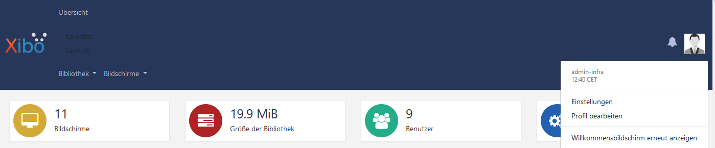

Here you can see the broken layout for the first login for a user (or when he changes the menu to horizontal). The name admin-infra is just a name, it’s a normal user:

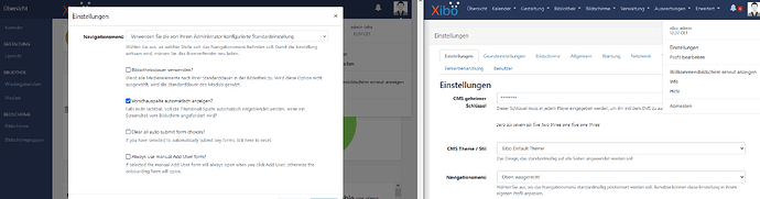

Here on the left you can see how it looks when the user changes it to vertical (or back to “use admin standard” as you can see what’s set in this screenshot). On the right you see that the xibo_admin has set the standard to horizontal (and that the layout worked for the admin):

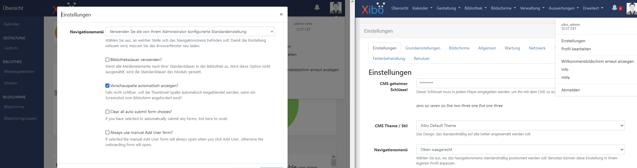

Now all rights that I have set for the usergroup (in which the user is). All settings(pages) you can’t see are disabled:
