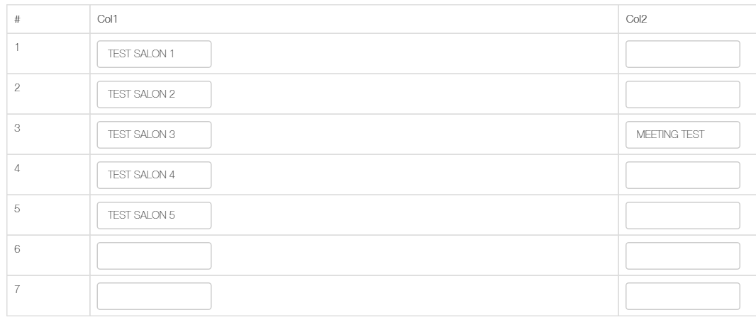

I have a dataset tree like this.

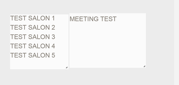

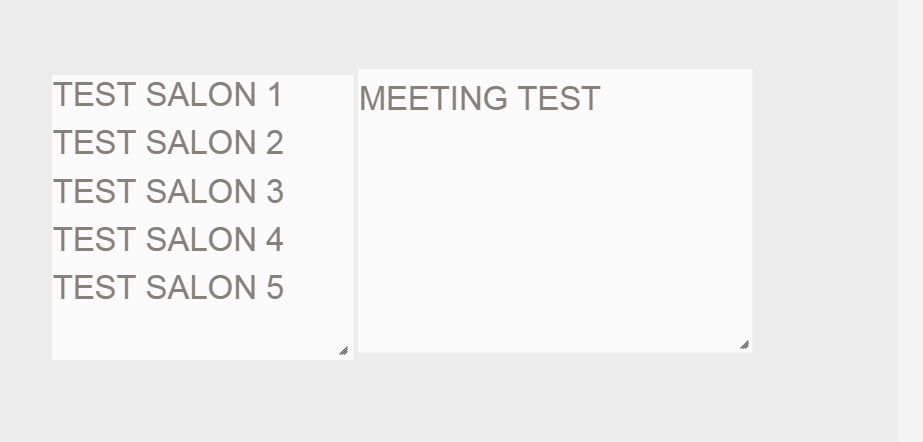

I used two dataset region for a design. On the left side I am showing the name of the salon to opposite I am writing the meeting name. But here is my problem. Because of I use 2 region. If I don’t have any value inside of a cell It is not putting a space. It is showing the value at the top.
Like this;
In this example MEETING TEST must write opposite of TEST SALON 3. But It is putting on the top of the layout because there is no value on the other cells. If I write   to the empty cells It is showing how what I want.
Before I was using this method properly but I was using only one dataset and it was showing. But when I add two region it is showing wrong. I mean I must do some ordering or formula but I don’t know these things.

I’d definitely suggest 1 region with your dataset.
Now you have two options ticker or dataset view modules.
For ticker you can perhaps more user friendly edit the output (like in text editor) + css (if needed)
