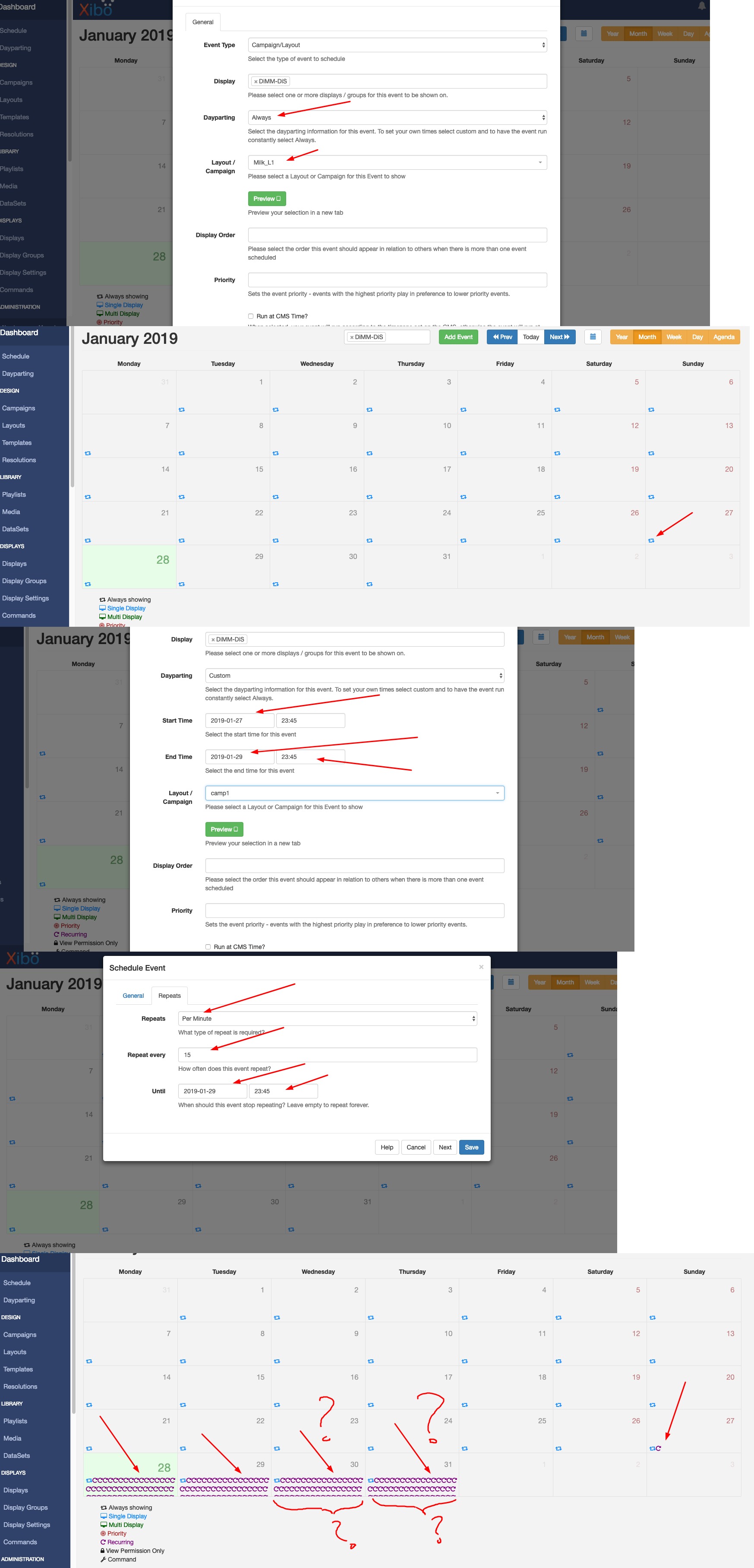

Hello. I created layout A and its display time is 15 minutes. I created layout B (display time is 10 sec) with a repeat rate of 15 minutes and a date from January 23 to February 9.
1 problem: Repeats were created before February 25
2 problem: Every 15 minutes, playback of layout A ends. And starts playing layout B with a very large number of repetitions in a row for 10 seconds. In this case, the number of consecutive repetitions is equal to the number of drawn @Recurring in the schedule.

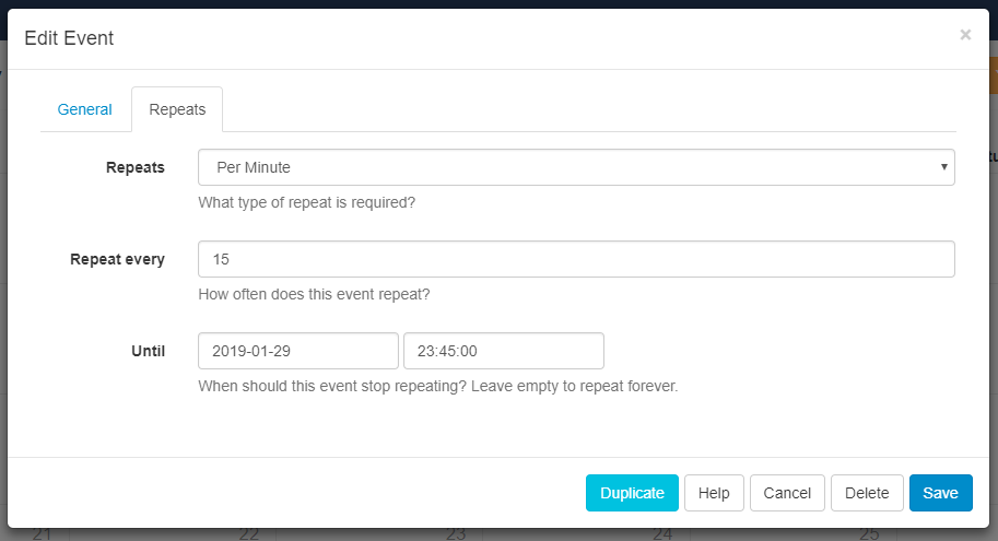

Thank you for the screenshots of your schedule. The second Event you have set up to repeat every 15 minutes may not been configured correctly.
According to that second Event’s configuration, you have set it to Display from 27/1/19 @ 23:45 until 29/1/2019 @ 23:45, which is a total display time of 2 days. You have then asked it to repeat that 2 day period every 15 minutes.

Thanks for the quick answers. I would like layout B to be displayed every 15 minutes from the 28th to the 29th day of the month, after layout A.
But the scheduler writes until the 31st of the month. And at the same time, model B plays without a break with 15 second rollers 40periods in a row, after model A loses its 10 minutes.

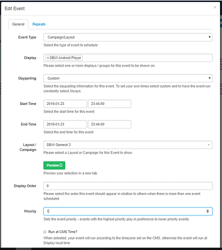

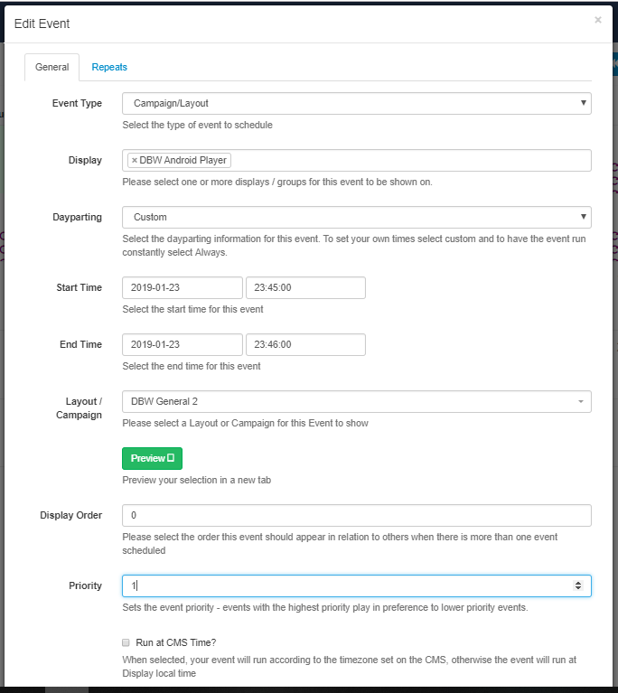

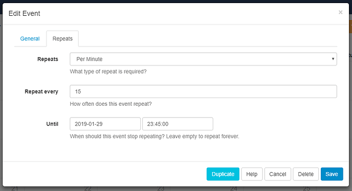

Assuming you wanted Layout B to display from 23rd January at 23:45, every 15 minutes, for 1 minute, until January 29th, you would want to set up a Layout like below:
As you will see in the above screenshots, the Start Time and End Time are set from 23:45 on 23rd until 23:46 of the same day. This makes the total length of time that the Layout will show for 1 minute. I then used the repeats tab to set that 1 minute time period to repeat every 15 minutes. The Until date on the Repeats tab is then used to tell the Event when to stop repeating.
Please also note that I have set the Priority of this Event to 1, to ensure that this Event has a higher Priority than the other Layout running always. This way, when the 15 minute interval arrives, this Layout with have priority for that 1 minute period that we set it to show for.
