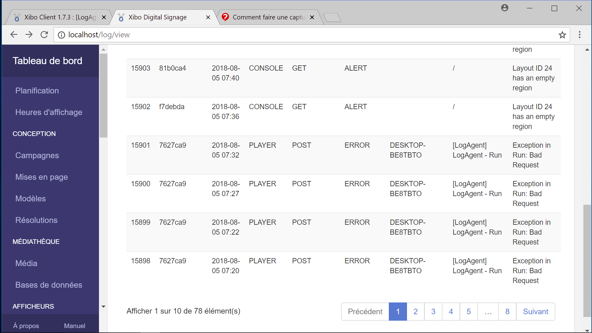

Here is my display DESKTOP-BE8TBT0 log
i connect to cms another player and it’s the same thing i scheddule a layout and it shows the default layout

What CMS and player versions are you using please?
If you have scheduled layout id 24 then it seems to have an empty region, as such it will be marked as invalid and player will not show it.
Alternatively player may have problems downloading files from CMS.
It would be best if you could show us a screenshot of status window on your Xibo player.
