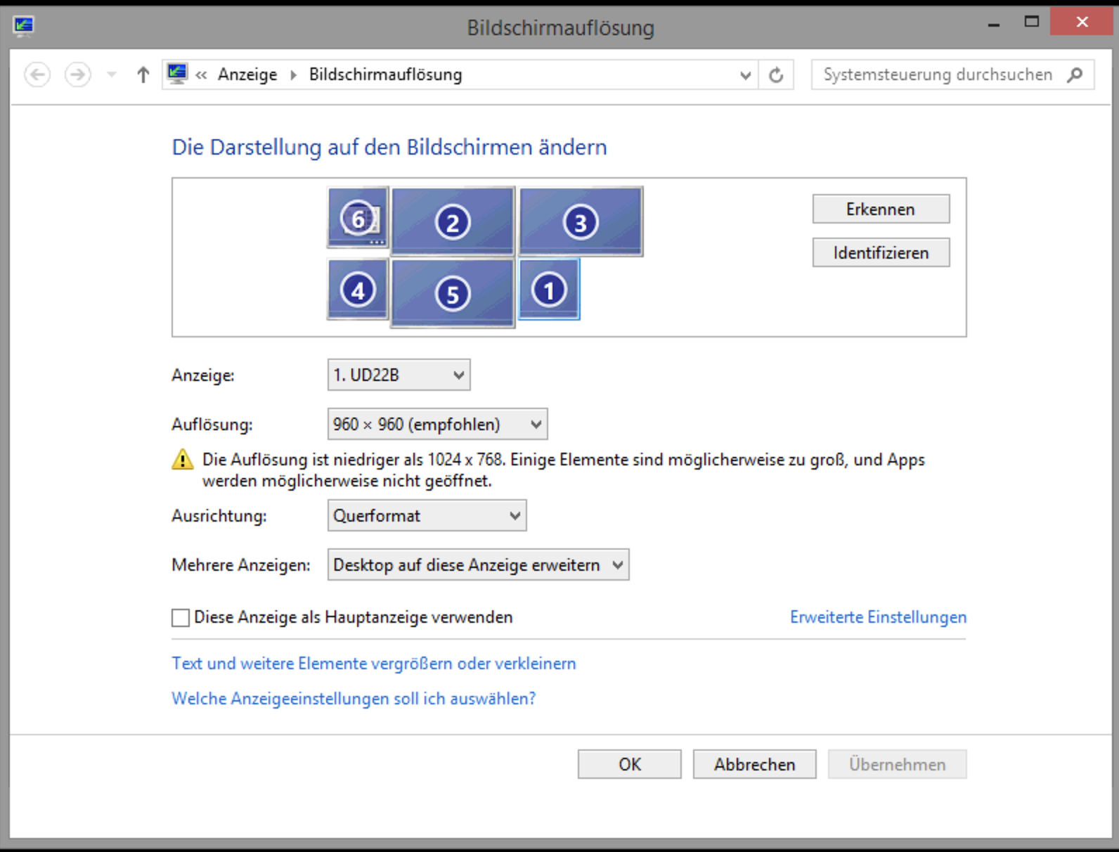

I have a problem with my installation of multiple Xibo instances at our customer’s video wall.
We have a PC with 6 video outputs that are separately manageable.
The videowall is made out of 6 monitors, asymmetrically like this:
I have installed multiple instances as explained in the detailed guide Multi Player Install | Xibo Digital Signage.

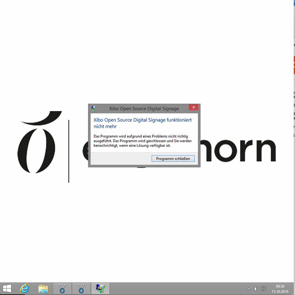

But I am facing a problem, that the instances start up properly but close one after another. I made a screen capture and uploaded it to show you my problem.
https://vimeo.com/366444420/d7f08ff8a0
After the instances are closed for about 1-2 minutes, or if I try to restart the instances manually via the XiboClient.exe (or XiboClient2 / 3 etc) I get an error message that translates to:
Xibo Open Source Digital is not working anymore. The program doesn’t run properly because of a problem. The programm will be closed and you will be notified once a solution is found. (Close program)
I assumed that the watchdog is causing a problem, so I renamed the watchdog.exe to something different to hinder it from booting up.
