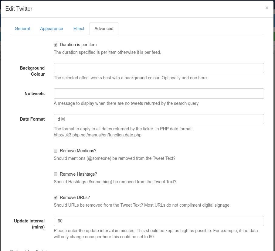

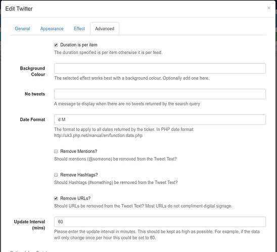

Thanks Alex, can you direct me to where the cache setting is in the widget? I have the module itself set down at 5 minutes.
Good point re the Twitter search metrics - I figured we would be at their mercy to some degree!
Advanced - update interval:
Thanks! Yep, I had that configured correctly. It looks like new content is coming through, though as you say, how the Twitter Search retrieves and orders content is a mystery.
