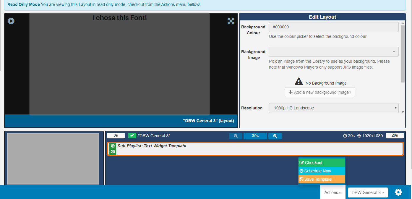

  • When you see the message that states This Layout is Published and cannot be edited. You can checkout the Layout for editing below, or continue to view it in a read only mode. You then need to click the Checkout Button so that the Layout can be edited. You will find the Checkout button as shown in the below image:
If this box has been closed, you can also find the Checkout button by clicking the Actions option at the bottom of the Designer. You can see it in my screenshot below:
Once you select Checkout, you can now edit your Layout. Once you have completed the changes, you will need to click the Publish Button to confirm the changes. You will see this in the bottom right corner of the designer, it’s a Green button with a Tick:

You can indeed create a Template in Version 2 of CMS. If you already have a Layout from your previous CMS, you can import it into your CMS or you can create a new Layout. Once you have set it up as you would like it to be for your Template, Publish the Layout in the way I described in my previous message. Once the Layout is Published, you’ll see in my Screenshot previously when I was showing you the Actions option that the 3rd option is Save Template:
Once you have saved the Layout as a Template you can go to the Template menu option in your CMS to view and manage them.
If you want to use the Template, simply create a new Layout but choose the Template from the menu option when first setting up the Layout:

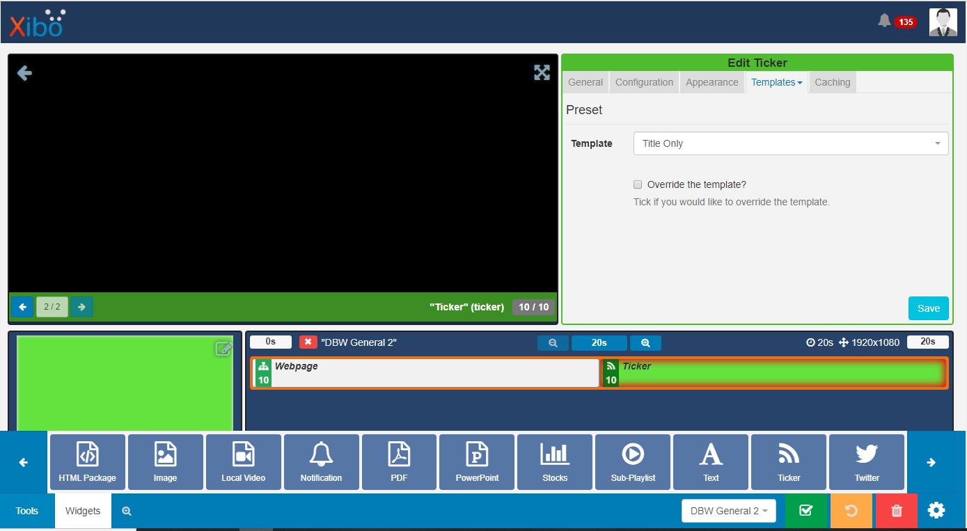

Regarding the Font size in your Ticker, you can change that in 2 different ways. Whichever way you choose, you will first need to select the Template you plan to use (I’ll use Title Only for to demonstrate):

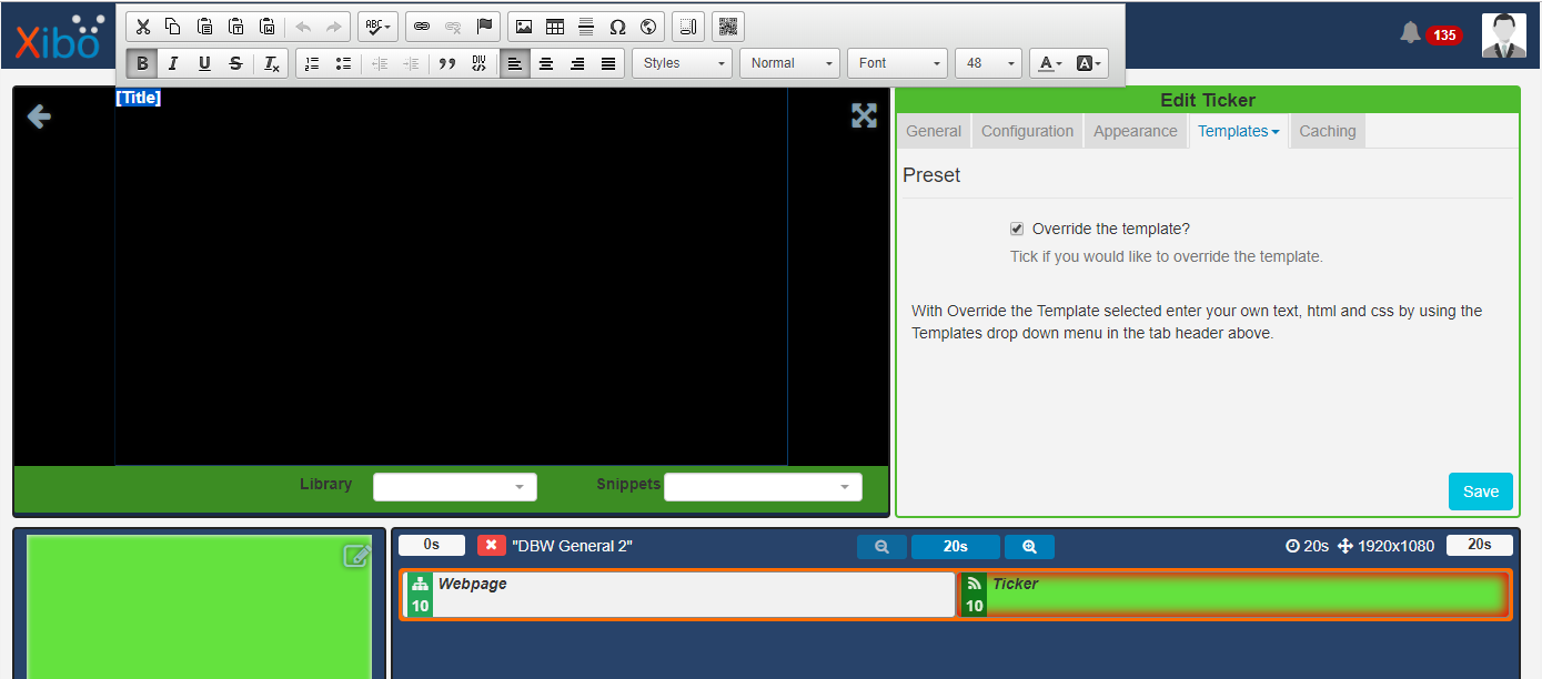

Now Tick the Override the Template box, you will see a change to the preview window to the right of the Edit Ticker window, it should have a small box with a pen inside icon:
Click that Icon and now the Preview Window will reveal the Ticker text editor:

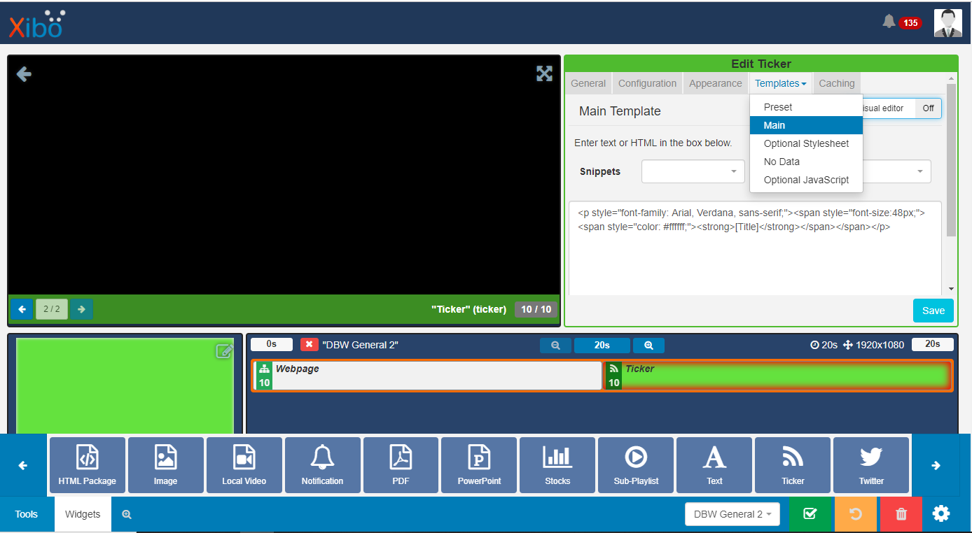

The second method is after you have ticked the Override the template box, instead click the Template tab in the Edit Ticker window and choose Main from the menu. You will now see a button named Visual Editor, if it is set to ON, simply click to set to OFF. Now you will have a stylesheet you can use to adjust the Font and other elements too:

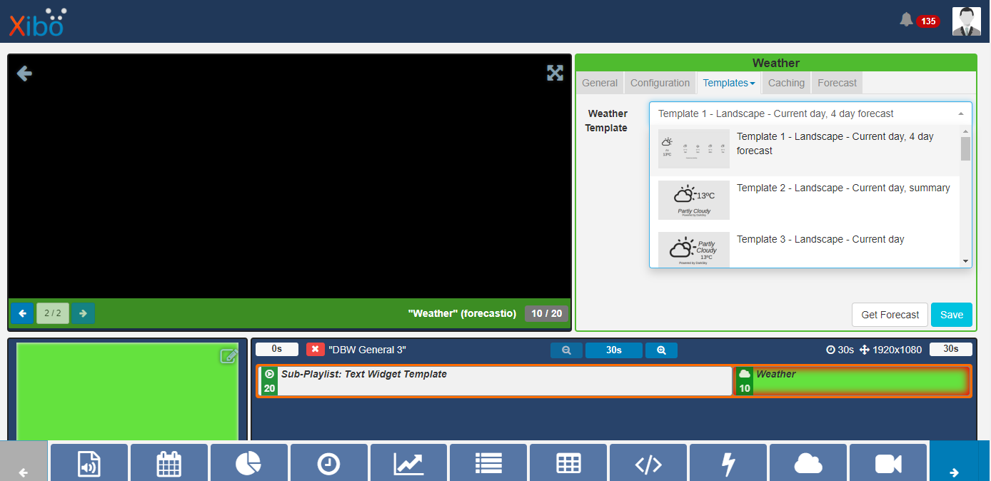

You should find that the Weather templates are the same in Version 2 CMS, you can access the templates under the Templates tab on the Edit Weather window for your Widget:
