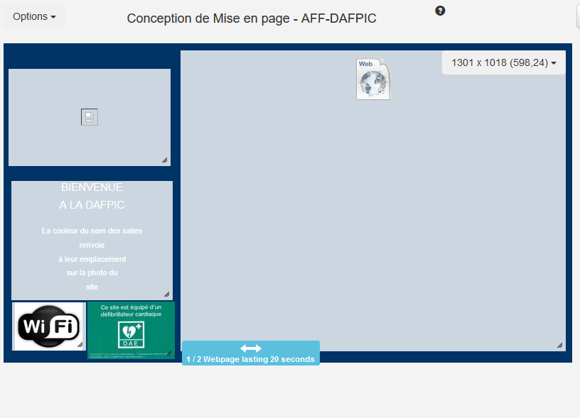

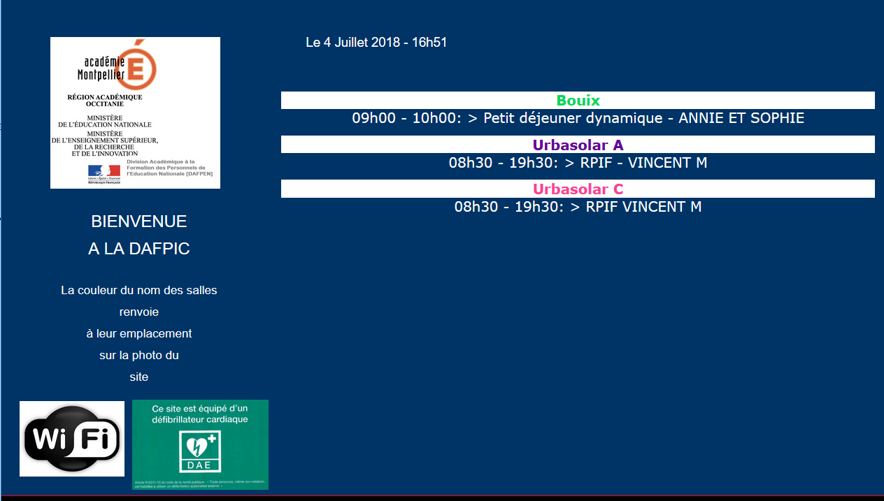

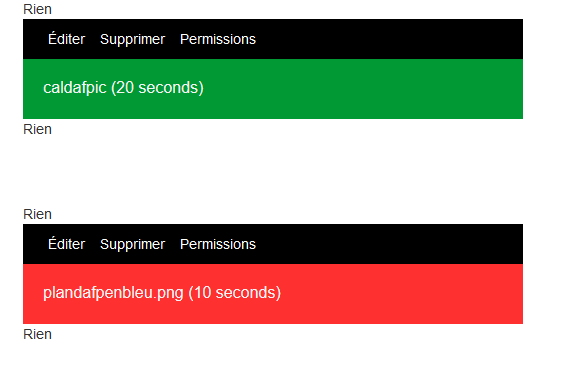

Thanks a lot for the quick response, and excuse my bad english, may be I will use the wrong words and be incomprehensible 5 regions : region 1 :region 2 : =1 webpage + 1 image region 3 texte, region 4 et 5 : images (.jpg) No, I think that it is the problem. Each time the error occurs, I find a lot of processes Xibo running (5 or 6) In some cases I found that TREND causes problems with applications or installations It stops working and I have to kill xibo processes to start it properly again I will try to send it to you next time
