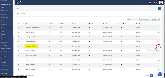

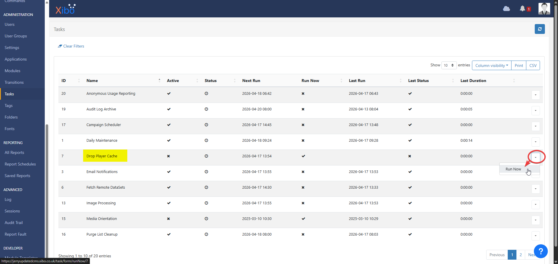

You may also try to clear the player cache in the CMS Task section by running the ‘Drop Player Cache’ task. To do so, click on the row menu of that task. and then click on run.

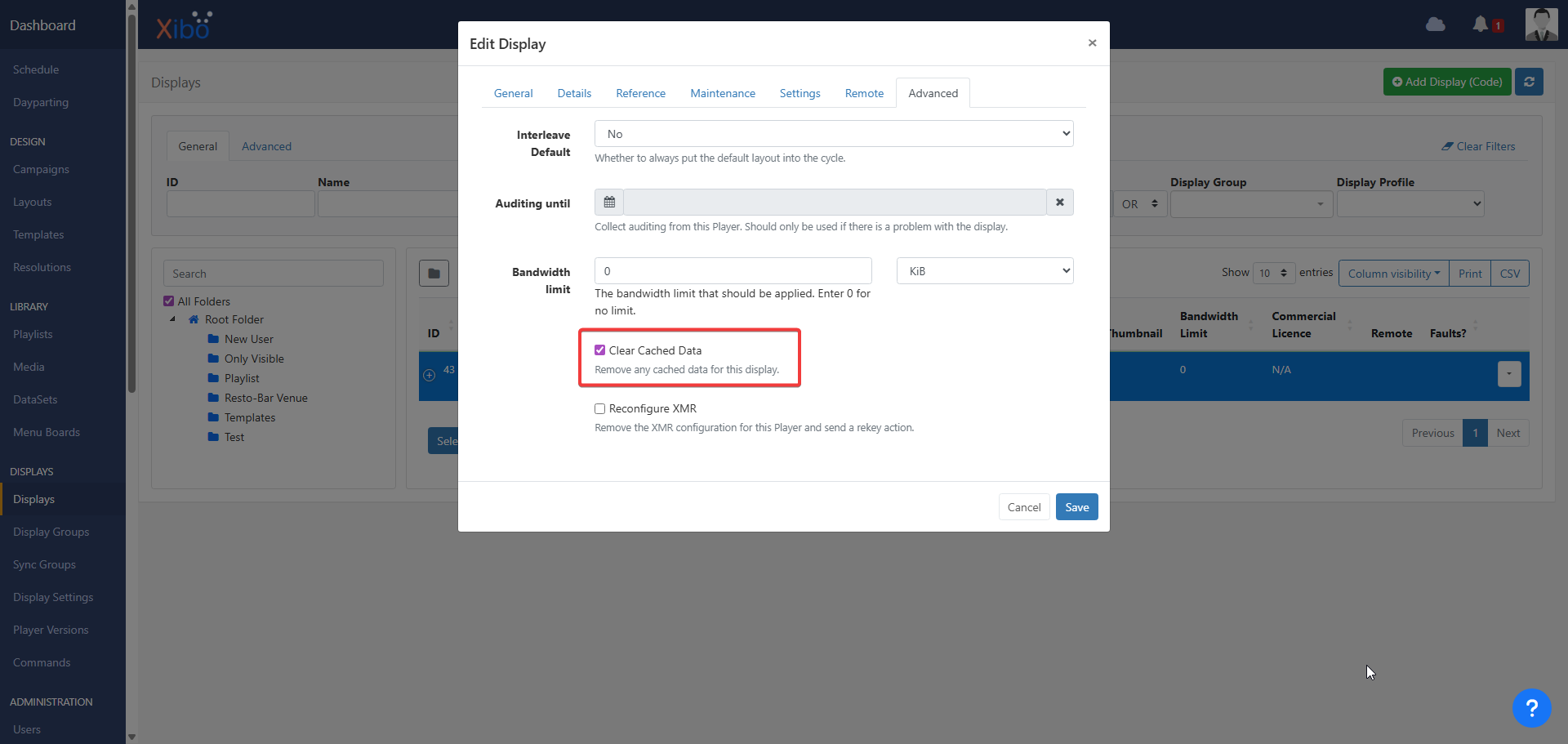

Next is to clear the player cache in the CMS’s Displays section. To do so, click on the row menu of the player reporting the fault, then click on Edit. Go to the ‘Advanced’ tab and tick on ‘Clear Cache Data’. The player should clear out any error logs in a couple of minutes after clearing its cache. However, if you notice an issue with your scheduled contents not showing on your display, then please try to get a screenshot of the ‘Player status log’ from your XfA player app for us to have a clue on what the player is doing to give us a hint on what could be causing the issue. To do so, you can find the steps here.
