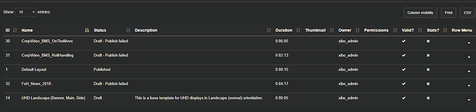

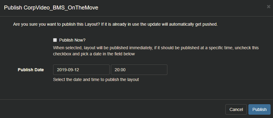

I have set up a new Xibo instance after failing to be able to upgrade certain details. During the publish for certain items, we have times that we want to make after-hours changes with Xibo (2.1.0). However, while a draft will publish just fine if done immediately, and “Publish @ XYZ time” drafts fail.
Draft Failed To Publish On Schedule

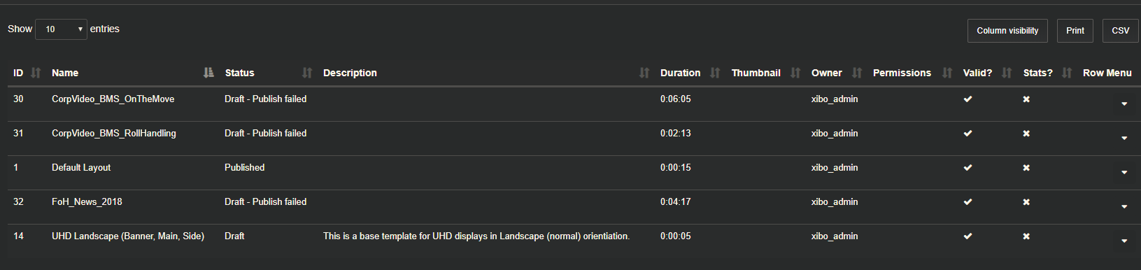

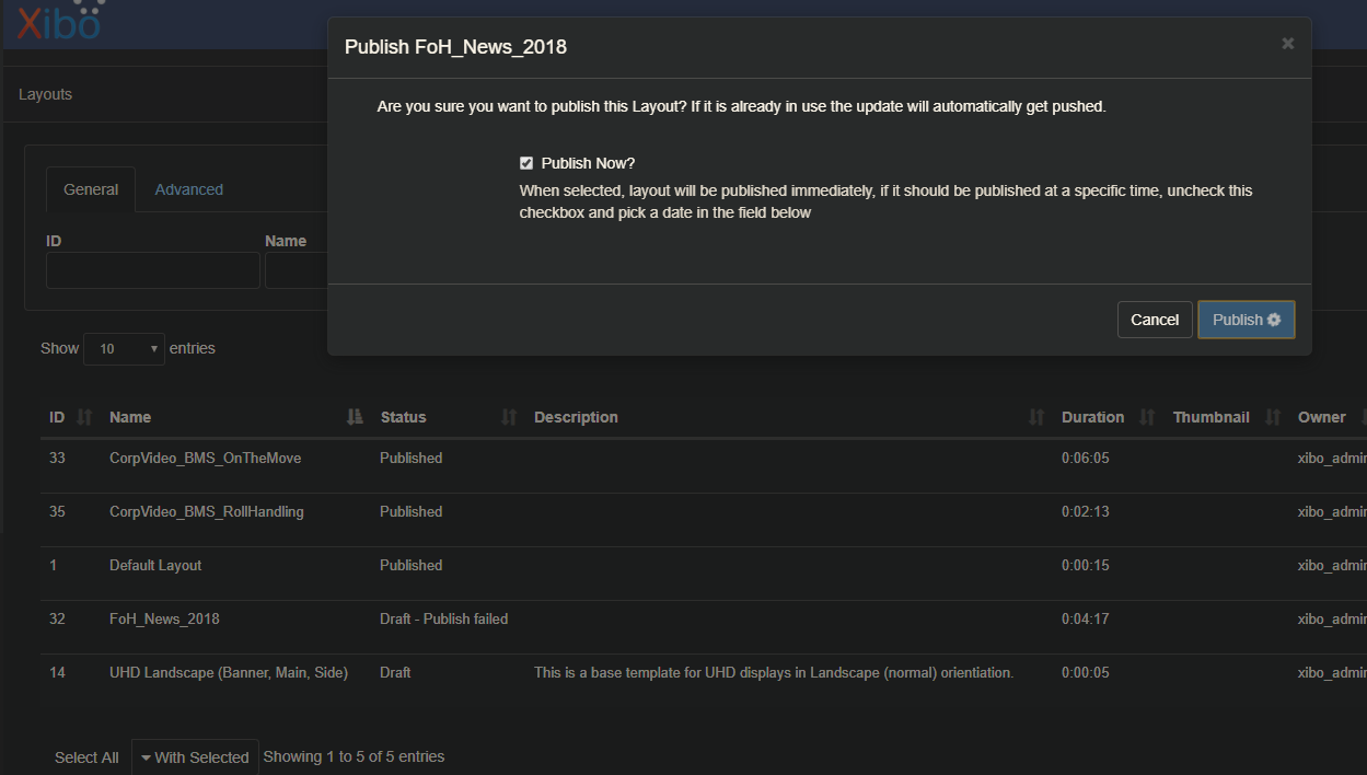

As you can see, ther are three items that failed to publish; all were changes that I published “later” per the schedule dropdown:
Publish Later Dialog

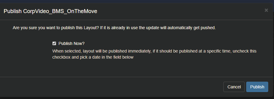

Publishes Fine Manually
There are no details in the log, so I cannot easily determine why these publishes failed to go automatically. If I click on the draft rows, and tell it to publish now, it works just fine; so the layout is not the issue. I logged in tonight to discover none of the changes I had set up published after hours. Any ideas?

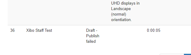

PFA the ZIP file as requested (Sign in to your account).

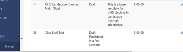

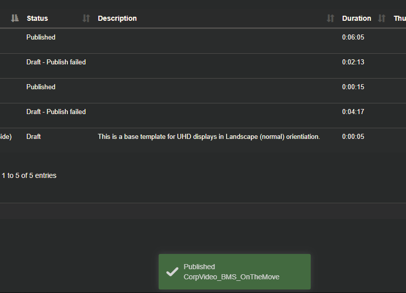

Also, here are a few screenshots during the process:

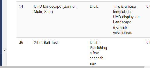

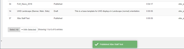

After clicking “Publish Now” after the failure, it published immediately:

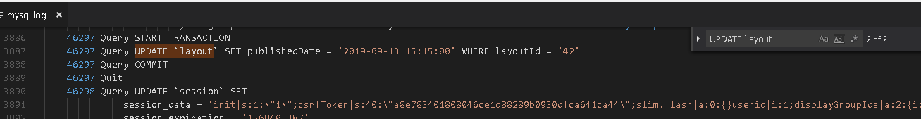

I did some MySQL tracing as well. I see where the layout is updated, and where the publish is scheduled:
Layout Update
46254 Query UPDATE layout SET status = 3, modifiedDT = ‘2019-09-13 15:12:12’ WHERE layoutId IN (
SELECT region.layoutId
FROM lkplaylistplaylist
INNER JOIN playlist
ON playlist.playlistId = lkplaylistplaylist.parentId
INNER JOIN region
ON region.regionId = playlist.regionId
WHERE lkplaylistplaylist.childId = ‘124’
Layout Scheduled
46297 Query START TRANSACTION
46297 Query UPDATE layout SET publishedDate = ‘2019-09-13 15:15:00’ WHERE layoutId = ‘42’
46297 Query COMMIT
46297 Quit
But I see nowhere after that where any updates are performed for the layout:

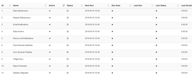

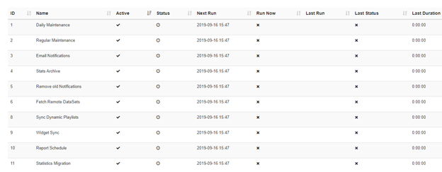

Thank you for the reply. This is a Custom Installation, using IIS as the webserver. I followed the “recommended” guide for Windows, and had no errors during installation. Here is a screenshot of the Active Tasks:
Active Tasks

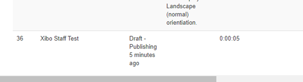

As well, after the time for the publish to occur, we see this:
Publishing
Tasks

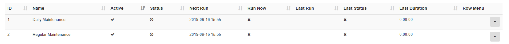

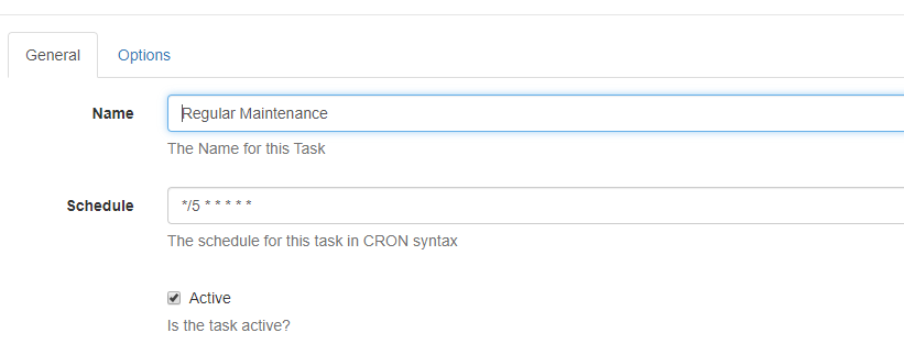

In reviewing, it seems like the Scheulded Tasks are set up as a CRON entry to occur every 5 minutes for Regular Maintenance:
Regular Maintenance Schedule
However, it seems the execution never occurs; every minute, it only shows that it is scheduled for the next minute. Is this specific feature required to be run in Linux, so that CRON is available for scheduling?
Thanks,
Paul
Thank you for the screenshots of the Tasks page. It looks like none of your Tasks are currently working.
I can see in your Next Run Column that it keeps updating to a future time, but you don’t have any information in your Last Run column, which suggests the Tasks are not actually running. Last Status is also a cross which again suggests the Tasks are not actually running.
When you schedule a Layout to Publish at a later date, it is your Regular Maintenance Task that will actually Publish the Layout. If it never runs, this explains why the Layout never gets Published this way.
