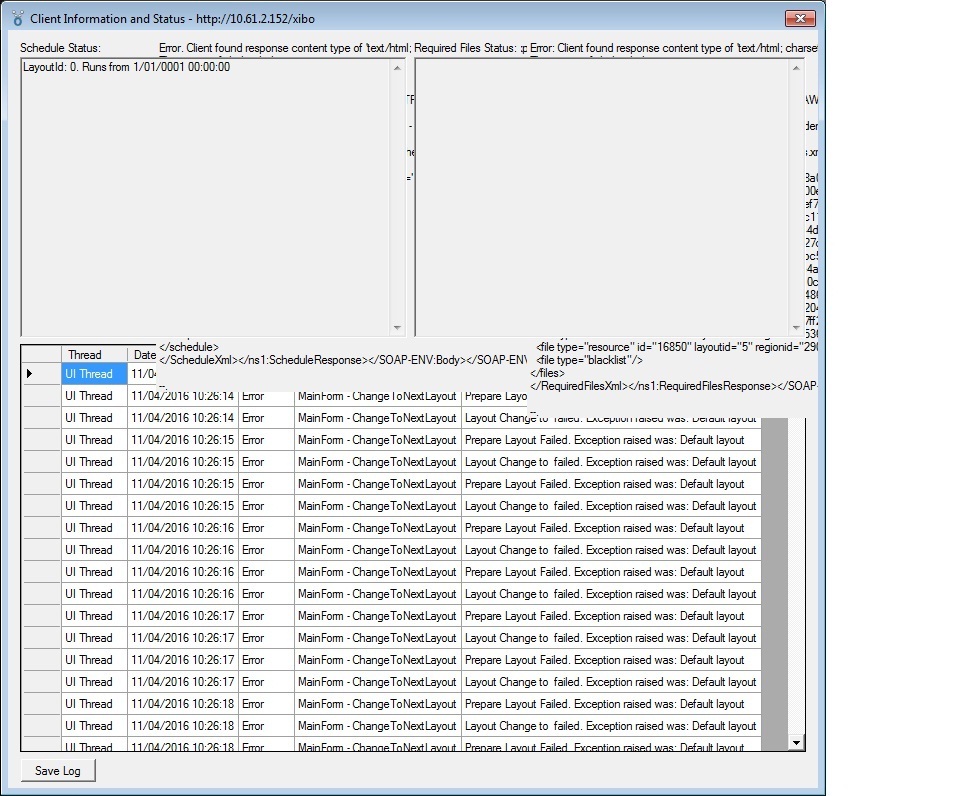

The client start automatically but we never play the Default layout.

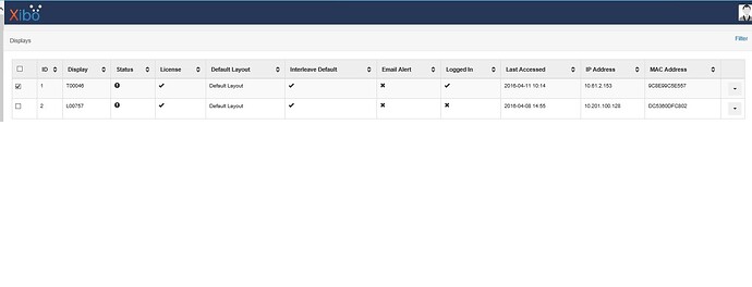

in the console i see the client witch this inofrmation
ID Display Status License Default Layout interleave Default Email Alert logged in ip address Mac adress
1 T00046 ! ok Default Layout ok X yes 10.61.2.153 9C8…
When i move the mouse on the ! the message is “Status display is out of date but has not yet checked in with the server”

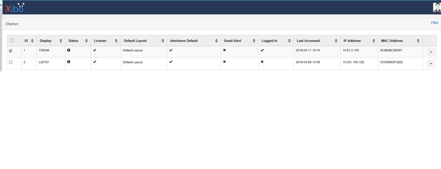

Printscreen on server
printscreen status on client
What’s your php version? Is SOAP extension correctly installed/enabled?
Perhaps also open php.ini and change ‘always_populate_raw_post_data’ to ‘-1’
Of course also double check that CMS URL and key are correct.
