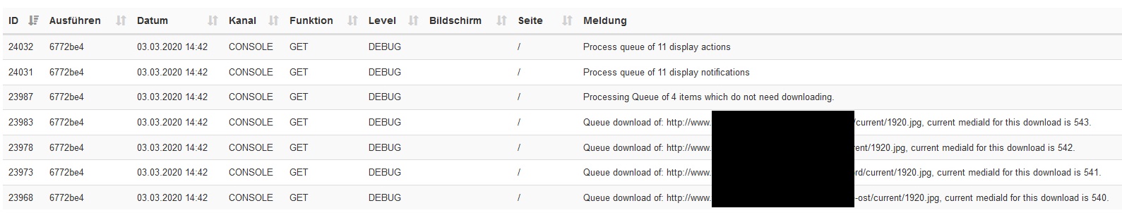

Given you’re a power user, i’m guessing all of the above is set up correctly. So would you be able give us a log of it not working? You can enable logging, and then set the “Fetch Remote DataSets” to “Run Now” and then capture the logs or a report fault zip file.

Thanks for the logs - I’ve spent some time trawling through them and I can’t see any requests for your DataSet Ticker from the CONSOLE or XMDS log channels - only the WEB one (which is in the Layout Designer).
This suggests that the Widget wasn’t requested from XMDS inside the log window and therefore wasn’t in the required files set and wouldn’t have been kept up to date.
If you published the Layout after editing the cache period, then it might have taken a whole collection interval for the Player to request that file - so perhaps you didn’t log for long enough?
