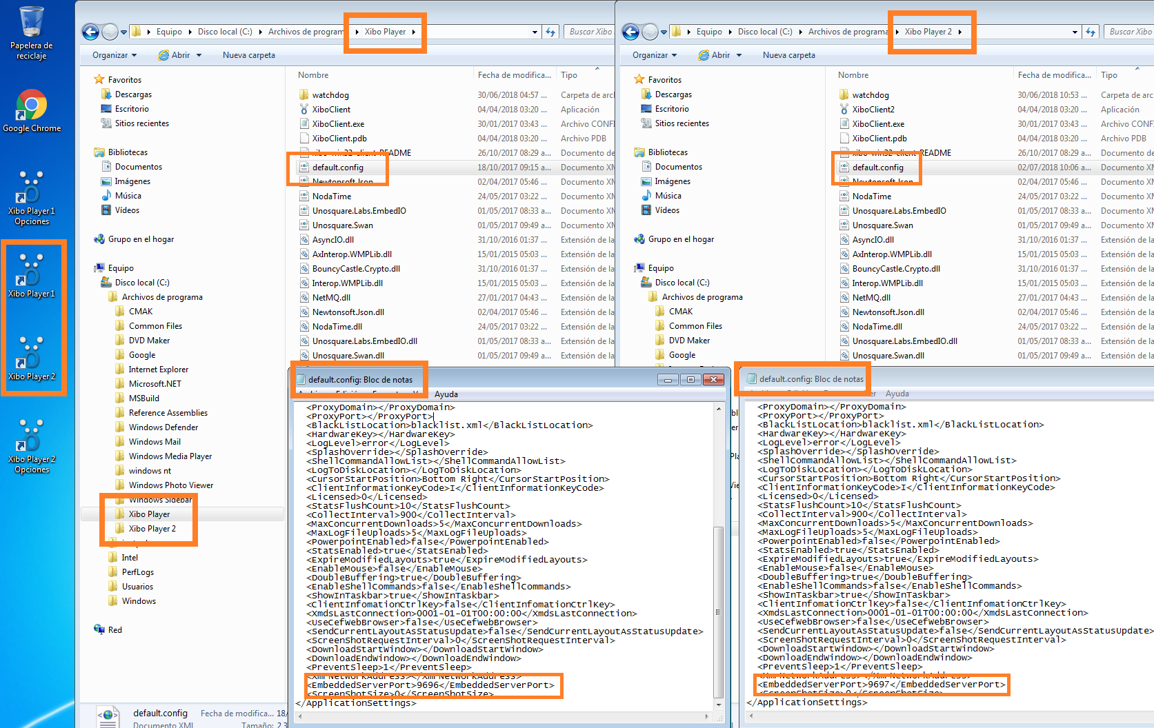

At a guess the Embedded webserver port is the same for both players which causes a conflict, please see - https://xibo.org.uk/manual/en/install_windows_client_multiple.html

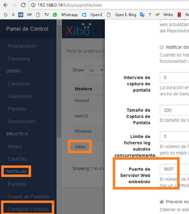

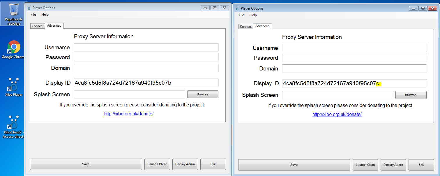

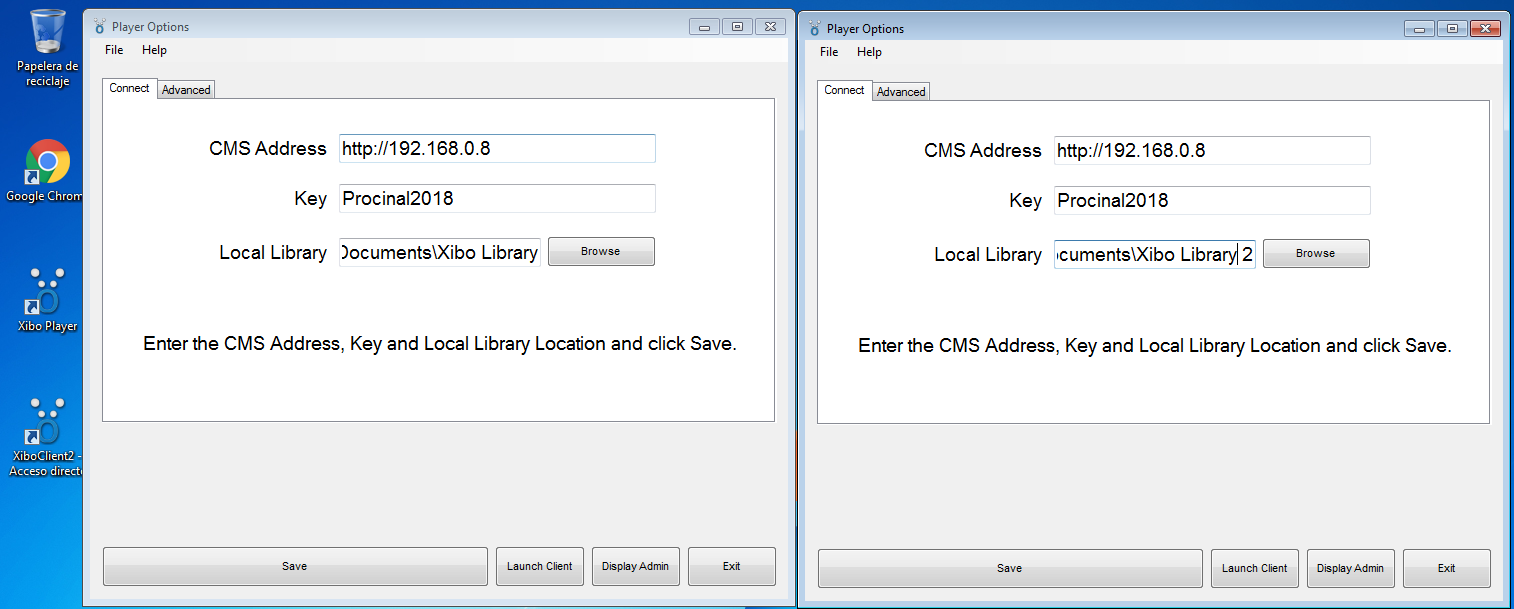

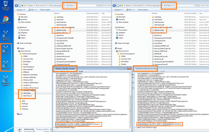

Hi. Effectively the problem was a port conflict between the instances, I made the adjustments on the server and on the client. I leave an image of the configuration that solved the problem in the client. Now it works perfect, thank you and happy day.
I’d highly recommend to change the embedded web server port in Display Settings -> Edit display profile -> Advanced tab.
You should not really change the config files manually, especially that they will get overwritten from CMS.
I actually made the changes on the server. Thanks to your help, the system is working perfectly. Thank you very much.
