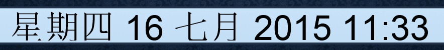

Ok I click Verify all and now the clock module appears with chinese character…
On layout preview clock module appears in french and on the client with chinese character

verify all now works well but the clock is still displaying in Chinese on displays (but not in preview).

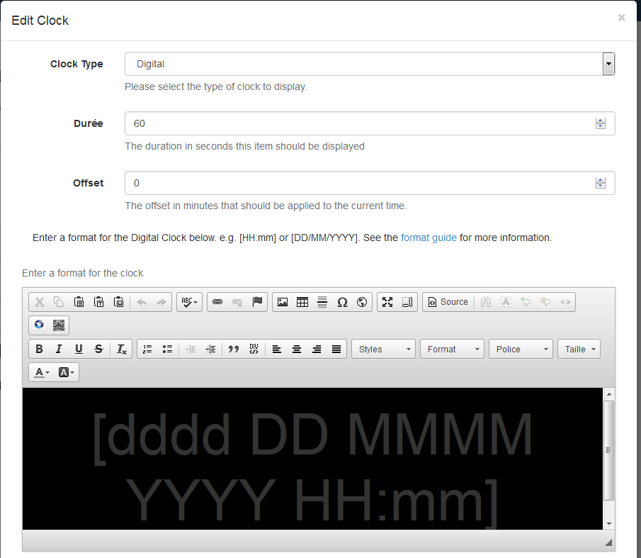

Here is how the clock module is formatted, if it may help :
[dddd DD MMMM YYYY HH:mm]
Are you using the Clock module or the Text module?
I am using the clock module. Here is the config screen :
And here is how it is rendered on displays :

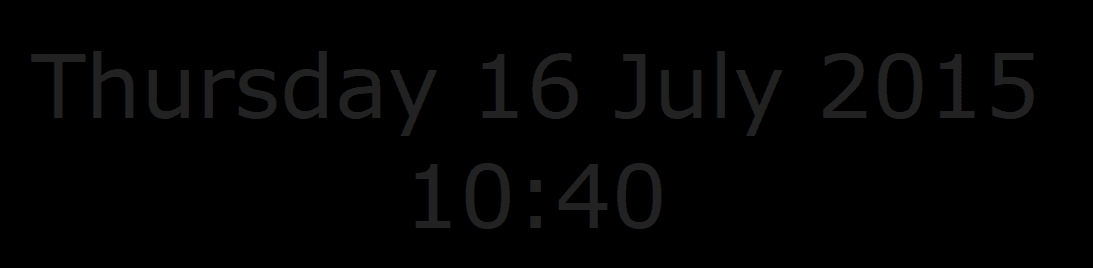

As it is working in the Layout Designer but not in the Player we need to try and extract the downloaded, formatted content from the Player library.
These are stored as .htm files in the local player library and are prefixed with a long ID. How many htm files you have will depend on the number of layouts/regions you have.
Your clock will have the following inside it (amongst other things)
<span class="clock" format="dddd DD MMMM YYYY HH:mm"></span>
Can you look through each one until you find your clock and then paste the contents of the file here between code tags?
Yup, link should point to - Clock module
Regarding clock module, it should just work without problems.
It does work for us, using the same date format as you are trying to, see:
For now please do what Dan asked you to do :smile:

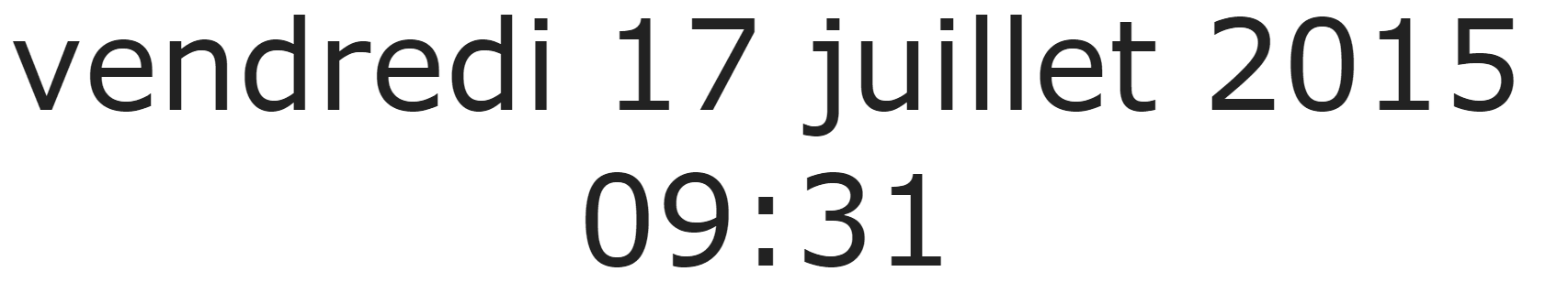

Indeed, setting var locale = “fr_FR”; in the .htm file fixed the issue. However I should not have to edit the file, should I?

Setting default language to fr instead of fr_FR and unchecking the detect language box made it work. I now get a nice French date/time.
Thanks a lot!
