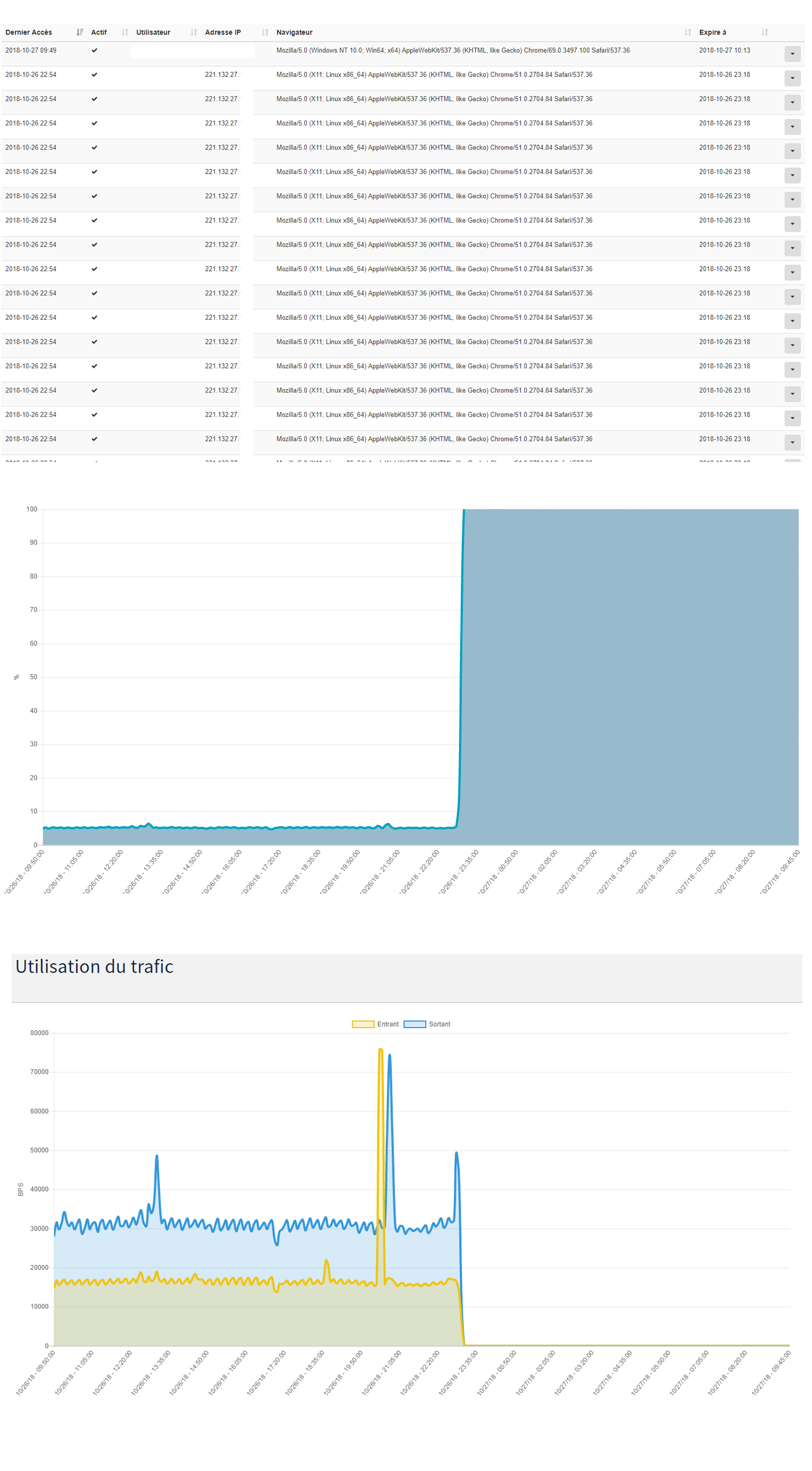

My VPS crashed four times this mounth, I saw on the monitoring that CPU was 100% and that the traffic increase before it (screenshot).
After restart it I can see that an unknowed IP adress was trying to connect on the CMS a lot of times.
I never had this problem before, but this month it happened 4 times.

The screenshots may suggest an attack, however you would need to further investigate to understand and resolve the issue.
If it is the session table in your screenshot, it appears to show a small number of IPs. It is possible that it could be that you have another service accessing the CMS, causing the high load in your screenshots.
You may want to look at your access logs to see if you can narrow down where the issue is coming from. If you are using a reverse proxy, then those logs would be a good place to start.
I cannot provide any further support on how to secure your web service but I do hope that you are able to locate the problem and resolve it.

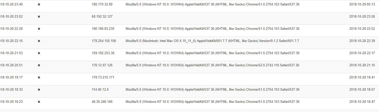

Last question : what does it mean if in the active column there is the “check” sign and if the user column is empty? Is the “hacker” logged on the CMS?
Capture
Thank you !
If the user column is empty, then that connection is not logged in.
Active simply means that the session has not expired. You get a session as soon as you load the login page.
