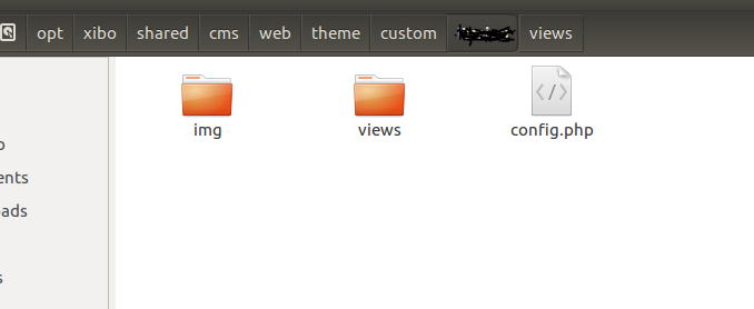

Thank you for the screenshot. The formatting in your config.php file does not look correct. All entries should be in line as below. I would recommend correcting the formatting:
<?php
$config = array(
    'theme_name' => 'Test Theme',
    'theme_title' => 'Custom CMS Theme',
    'app_name' => 'Xibo',
    'theme_url' => 'http://xibo.org.com',
    'cms_source_url' => 'https://github.com/xibosignage/xibo/',
    'cms_install_url' => 'http://xibo.org.uk/manual/en/install_windows_client.html',
    'cms_release_notes_url' => 'http://xibo.org.uk/manual/en/release_notes.html',
    'view_path' => '../web/theme/custom/test/views'
Can you talk me through the steps you have taken prior to the CMS login becoming unavailable? Did you access your CMS after creating these folders and change the CMS Theme in the Settings?
Can you also confirm if the login page returns when you remove the files and folders you have added to the /custom/ folder?
