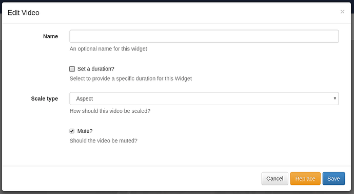

Good to know. Thank you. :slight_smile: Although I don’t see it??? I see an option to set the duration on both the media itself, and when adding the media to the layout. But nothing that says play till the end.

Apologies - it still says “Set a duration?” and should say “Play until the end”
